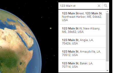

fggriffith
New Contributor
Is it possible to have the search widget auto-fill when it's outside of the map?
