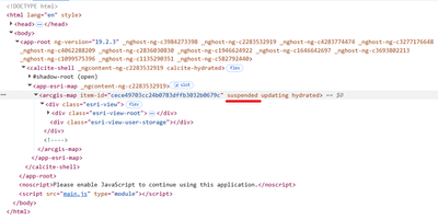

The map doesn't show in browser.
 I inspect the document:

You are right!
`<app-esri-map>` element needs a height and width in css:
app-esri-map {
  padding: 0;
  margin: 0;
  height: 100%;
  width: 100%;
It works!

If you could provide a repro to look at, would be easier to see the problem. If I had to guess, your `<app-esri-map>` element needs a height and width in css. The `<arcgis-map>` component will grow to the size of it's container, so the container probably doesn't have them.
