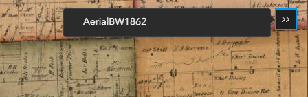

I thought I would be able to change the layer name from AerialBW1862 by using a label property in the Layer List component, but it has no effect. I've tried most other relevant-sounding properties, but still no effect. Here is a sample.

The layer name comes from the "layer.title", so you can add your own title when you create the layer.
Was just coming to post that. Example mod to your code:
const image1862 = new ImageryLayer({
url: "https://gis.willcountyillinois.com/image/rest/services/Orthoimagery/AerialBW1862/ImageServer",
title: "Aerial Photo",
maxScale: 3000,
