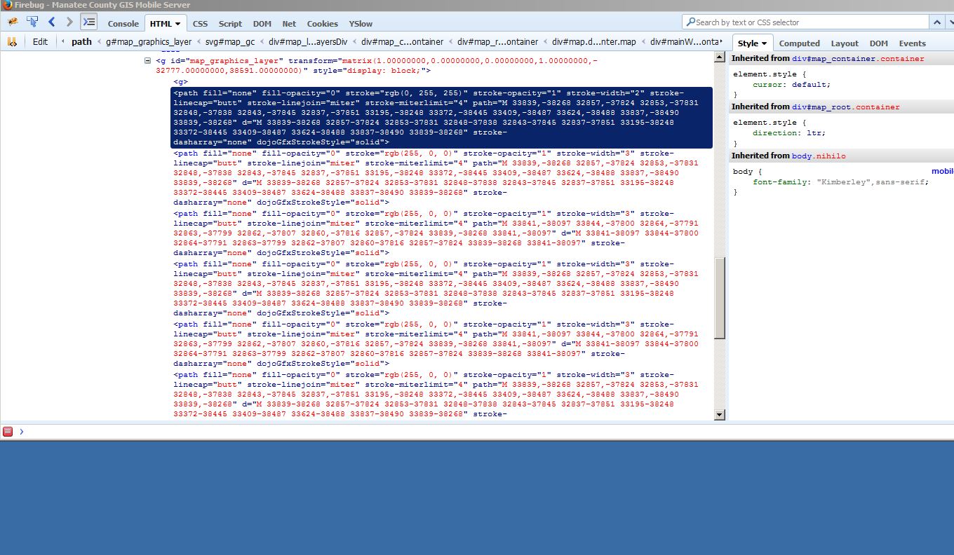

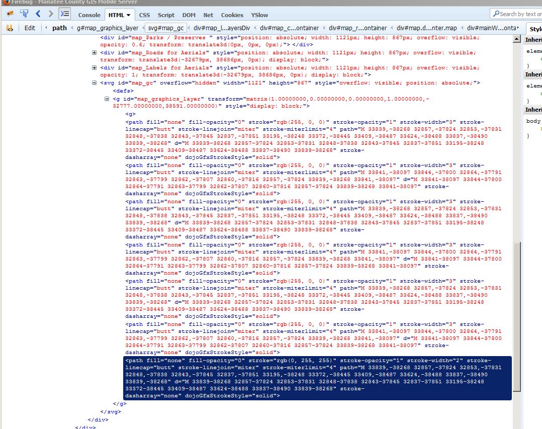

However the selected feature highlight symbol is ending up first in the list, instead of last, so it is drawing UNDER the feature, and therefore isnt appearing highlighted.  If i click the feature, the highlight moves to the bottom of the list, and draws correctly.
PATHS after hitting next
PATHS after clicking to select
