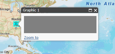

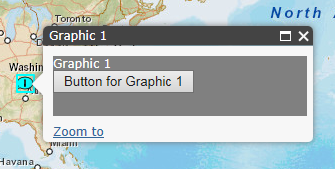

  2. If an element is set as the content for InfoTemplate and when we click on the graphics for first time we can see the infowindow as expected. However from next click on the graphic the innerHTML of element(which is set as content) gets cleared(Empty).
Infowindow content when graphic is clicked for first time:
Infowindow content when same graphic is clicked for second time:

2.Now click on the graphic. (observe that you will see the text "Graphic 1" and a Button) :

4.Now click on the same graphic again. (observe that you will not see the text and Button) :
