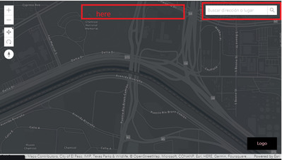

I need to center a graphic element on the map
2776
07-07-2022 08:49 AM
stiven
I want to position the search engine in the middle of the map, I have only found the positions of : "bottom-leading"|"bottom-left"|"bottom-right"|"bottom-trailing"|"top-leading"|"top-left"|"top-right"|"top-trailing"|"manual"
i want this:

stiven
Thank you very much, that worked
