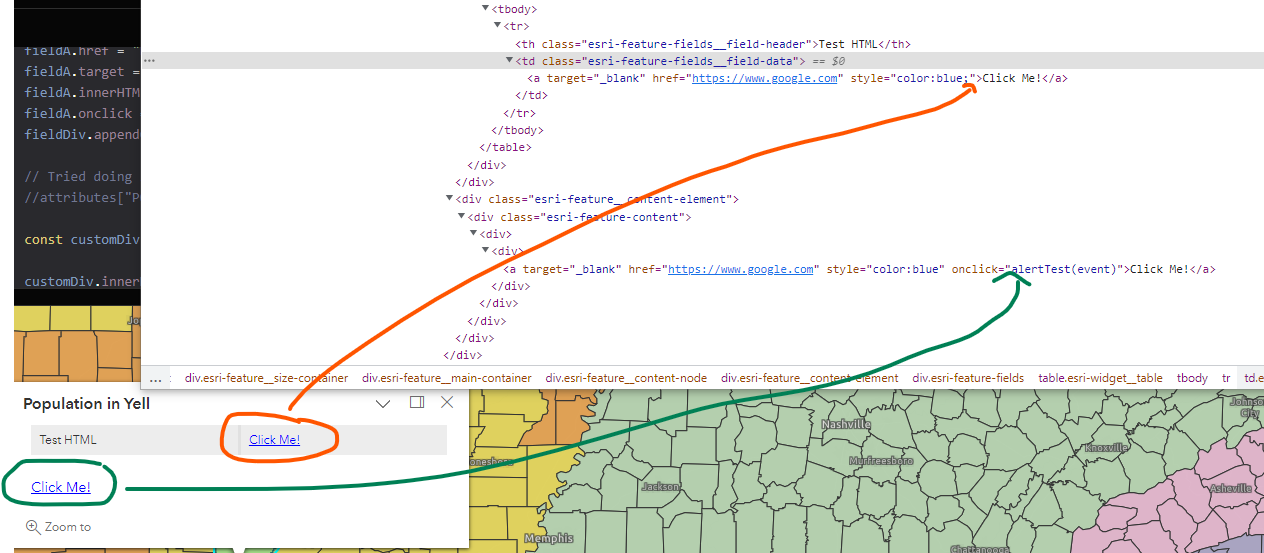

Hello,
I was originally on 4.11 and  updated to 4.26 and noticed that the when displaying field attribute values it no longer renders HTML as expected.  I did some Googling and saw that this is expected due to the added sanitize feature.  I was able to fix up some of my popup HTML content using CustomContent, but I'm stuck on the FieldInfo portion for FieldsContent.
Below is my sample code.  I was able to use CustomContent to display the HTML as expected, but not getting same outcome with Fields for onclick in populationChange function.

JoelBennett
MVP Regular Contributor
Have you seen this thread?  You'll find various proposed solutions to this kind of problem there.
2 Replies
JoelBennett
YimYean
Thank you so much.  That was the solution I needed.
