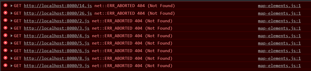

I have a very simple Angular app that generates 171 build js files from @arcgis/core. Is there a way to combine these into a single js file that can be referenced in a single html script tag?
For some background I'm using Angular Elements to create a native web component from an Angular component containing an arcgis js map. When I drop that web component in a vanilla html page I get console errors about the missing 171 js files. I need to bundle up the 171 files into a singe one but somehow keep the references intact.

Hi @ShaneBuscher1 I haven't used Angular elements, but with a webpack build you have to include all the output bundle files from the Angular build - main,js is just the entry point. Here's a couple blog posts that talk about the ES modules: https://www.esri.com/arcgis-blog/products/js-api-arcgis/announcements/arcgis-api-for-javascript-work...  and https://www.esri.com/arcgis-blog/products/js-api-arcgis/mapping/javascript-just-works/

Going to partially answer my question. I ended up copying the 171 files to the root of the html app in addition to the @arcgis/core assets. This fixed all of the errors and was able to display the map web component. However, still looking for a cleaner way of bundling all the files to make deployments cleaner.

I can add to this that I have tested a single file bundle. using webpack and you pretty much end up with a 7mb js file with tons of code you probably won't use at runtime.
