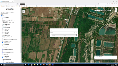

Vakhtang_Zubiashvili
Thanks kishore,
but look what result i get:
it sets values, it does not hides empty value row 😞
SumitZarkarCT
Please check how you have configured the POP-UP it will work in case of custom popups only and if you have edited the html. Please check if you have followed step 6-8 correctly from the link
If possible please share the popup configuration
