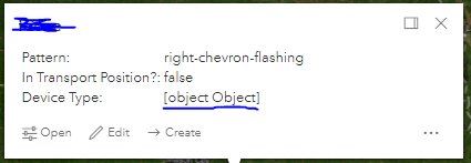

I am trying to make a GeoJSON Layer from a source I do not control. Everything works fine, but my one difficulty is that I have a property in the GeoJSON (example below) that is actually an Object, not a string/number, etc.
I am hoping to add fields from the 'core_details' property below into the GeoJSON layer, and into the popup template. Is this possible? Or does the GeoJSON need to be edited to split this object into individual properties? I am providing this layer a list of Fields to make this functionality work.

JoelBennett
MVP Regular Contributor
In this case, you may have to use a function to define your PopupTemplate content.  If you did, it might look something like this:
function getPopupContent(feature) {
	return "<table><tr><td>Pattern:</td><td>" + feature.graphic.attributes.pattern + "</td></tr>" +
		"<tr><td>In Transport Position?</td><td>" + feature.graphic.attributes.is_in_transport_position + "</td></tr>" +
		"<tr><td>Device Type:</td><td>" + feature.graphic.attributes.core_details.device_type + "</td></tr></table>";
var popupTemplate = new PopupTemplate({
	title: "My Title",
	content: getPopupContent
var layer = new GeoJSONLayer({
	url: myURL,
	popupTemplate: popupTemplate

JulianDurantini
Thank you @UndralBatsukh and @JoelBennett so much! My issue was that I needed the 'type' property of my Field to be a blob. I'm glad you took the time to add the obvious!
