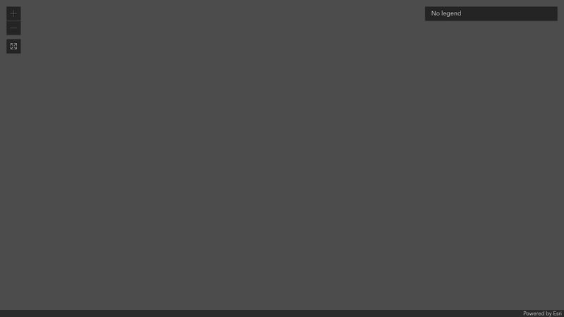

Brandon-Ellis
I tried that solution with our server url and got no joy.  I have included a screen shot because you will not be able to access the service from your location.  The legend reflects the color changes that I made, but the service does not.  We (the team working on this project) tried changing the default colors of the service, but the API renders the same colors despite all efforts thus far.
There are some differences in implementation.  We observed that you have the directional bands and and magnitude bands in the same service, but we use 2 difference services for the direction and magnitude.  The magnitude has only one band, so specifying the band does not seem to change anything.  We are open to trying any other ideas you may have.  Thanks!
