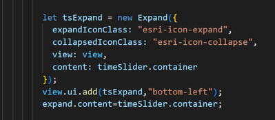

SaffiaHossainzadeh1
I am also having trouble getting a timeslider to be inside the expand widget. For me, it's not working at all. Here's my code and CSS:
I have tried various values for 'width' in the CSS since that is what the documentation called for.
I have also attached the full application. My timeslider is initialized in a view.whenLayerView() function, similar to LuisanalG's example above. Inserting my legend into the expand works, but not the timeslider. Nothing happens when I run the code - the timeslider still appears as it did without the Expand widget.
Any guidance will be appreciated!
