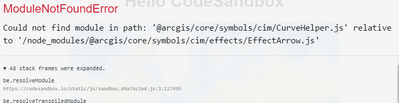

LaurynasGedminas2
I try in codeSanbox and I get:
SethLutske
I had the same issue.  CSB or parcel doesn't seem to understand we're trying to import from a remote url, not a node module.  Rather than spend too much time on that, I made a static sandbox that I'm now using as a template.  Feel free to fork it:

LaurynasGedminas2
Cool, thank you,
gives error:
PatrickMcKinney99
I am also getting an error when running "parcel build" using the @arcgis/core package.  I'm using version
2.5.0 of parcel.  Any tricks to get the build command to work with parcel?
