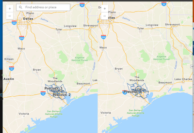

I am very new to JavaScript SDK.  I can't figure out why I have 2 maps in my view.
Here is my code:

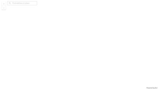

It looks like if you would also need to modify your css rules to give the div a height.  Here's a codepen.
https://codepen.io/sagewall/pen/bNEVwKr?editors=1010

There are now two ways to make a map in the Javascript API. The old way looks something like this:
const webmap = new WebMap({
          portalItem: { id: "8914d03ca2d745bea3beec1155d0614b" }
        const view = new MapView({
          container: "arcgisMap",
          map: webmap
And the new way looks like this:
<arcgis-map id="arcgisMap" item-id="8914d03ca2d745bea3beec1155d0614b">
You did both. So you made two maps. Do one or the other and you should be fine. ESRI prefers you use the new style, so try to go that way.

Hi @JaysonLindahl ,
You are mixing the old MapView and widgets API with the newer web components API.  Your seeing two maps because you have an `<arcgis-map>` component displaying a web map and then you are creating a new MapView and adding it to the `<arcgis-map>`.  If you replace the `<arcgis-map>` with a `<div>` it should work, but you might consider taking a look at this tutorial for how to do this all in the new components API.
https://developers.arcgis.com/javascript/latest/tutorials/query-a-feature-layer-spatial/
JaysonLindahl
Thank you very much.  I will look into those articles and work to understand the newer components.
