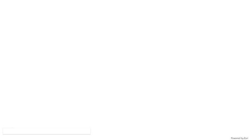

I have to be doing something wrong because I can't get these tools to show up in the map I'm rendering with layers and other widgets.  If I just do a basic map render and follow your example it works.  But the second I try to do the same thing to my map it won't render the same and it appears to put the controls outside the view when I write them to the DOM.
