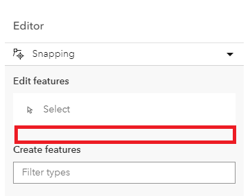

I would like to add custom tool that would allow me to add polygon part to existing multipolygon feature. I believe there is not such tool available but I have an idea how to implement it. The problem is that I don't know how to add a button in editor widget in "Edit features" section. Is it possible or should i write editing panel from scratch?
