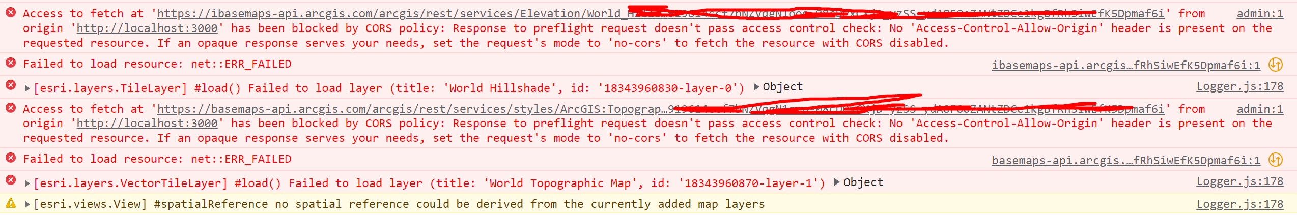

Now when I run my application locally I keep getting the following CORS errors:
Access to fetch at 'https://ibasemaps-api.arcgis.com/arcgis/rest/services/Elevation/World_Hillshade/MapServer?f=json&tok...}' from origin 'http://localhost:3000' has been blocked by CORS policy: Response to preflight request doesn't pass access control check: No 'Access-Control-Allow-Origin' header is present on the requested resource. If an opaque response serves your needs, set the request's mode to 'no-cors' to fetch the resource with CORS disabled.

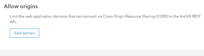

I fully understand how CORS works in a normal web/server applicartion, but here I cannot understand how I cann allowe my localhost (or the full app url once deployed), from my  ArcGIS online Developer Dashboard.
In my ArcGIS online Organization settings I left the "Allow origins" list empty, this shoudl allow all.

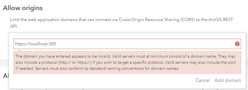

But even if I try to add https://localhost, this is not accepted by the system.
Am I missing anything?

Hi All,
I solved my problem disabling Azure App Insights JS library for my project (actually I just disabled arcgis domain).
The library intercepts all the requests and inject some custom headers to trak them, and this was causing the CORS issues.
For people looking at this issue in the future, make sure you don't have any tracking library enabled, or other library that manipulate your http calls (like Azure msal for example)
