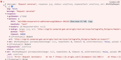

H__DanielRamos_Mendoza
Good afternoon, Markus Ehm1
I had a similar problem. In my case I use MapViewer. The MapViewer uses version 3.21(https://js.arcgis.com/3.21compact/) I changed it to 3.41 (https://js.arcgis.com/3.41compact/) and everything worked without problems.
Atte: HDRamosMendoza
