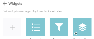

It has now come to my attention that the way to activate a widget on app startup is by the little dot in the bottom left corner of the widget icon in WAB.  You can set one widget per controller to activate on app startup.
However, as I would like to know if there is a way to do this from within the widget, I'll leave the question open for now.
