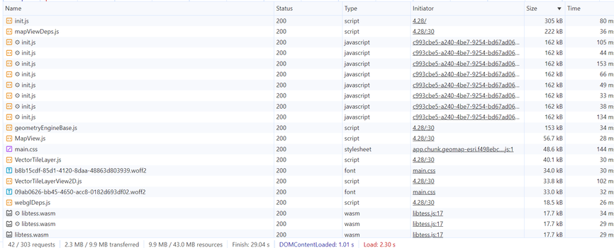

i read somewhere that the number of init.js requests that ESRi spawns is somehow related to the number of cpu cores you have. is that true? is there a way to configure or control the number of requests that esri makes?
on my laptop, i see 8 requests after the very first init.js request.
for our application we are really sensitive to what we initially download and i'm trying to investigate if there's anything further we can avoid downloading and these 8 requests are quite obvious.

Thanks for checking that @AndyGup  much appreciated!
i did some runs yesterday with esri 3 and did notice stalls as well so not specific to esri 4 - you're right.
Thanks.  Let me know if you come to any conclusion as to why the size of the workers jumped to 163k.

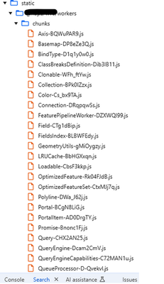

I am facing a similar issue with a custom application built with arcgis-core 4.30 with vitejs. In my case, the issue is that there is not only the `init.js` file that is requested many times but many, many, many, many javascript files !
All files are cached and served from http/2, but even with all these performances considerations, there is still a very noticeable period with no features displayed. At startup, we end up in few seconds in the following situation with the TOC created, basemap loaded:

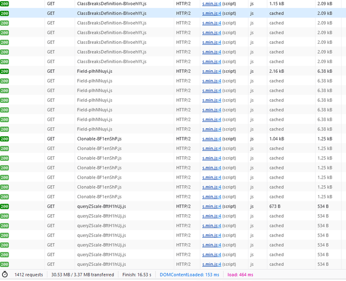

but in the backend, it spends its time loading several times (7) a big number of files even from the cache:
or another example:
Once it's finally done loading these files, it starts querying the ArcGIS Server to retrieve the data and features start behind displayed.

Many (most?) of the cache hits that appear to be duplicates are likely related to the APIs web-workers working in parallel. Also, the browser, itself, is making parallel http requests. Oftentimes, what may seem to be sequential activity isn't necessarily so, and you have to look carefully at the network "Timing" section of the Chrome dev tools, or use a more advanced tool like Charles Debugging Proxy. Initial load time is a multi-factorial issue that includes not just the API modules, but also how the app is constructed, the data, the number and types of layers, the type of queries, how the layers are constructed, etc. I hope that helps.
