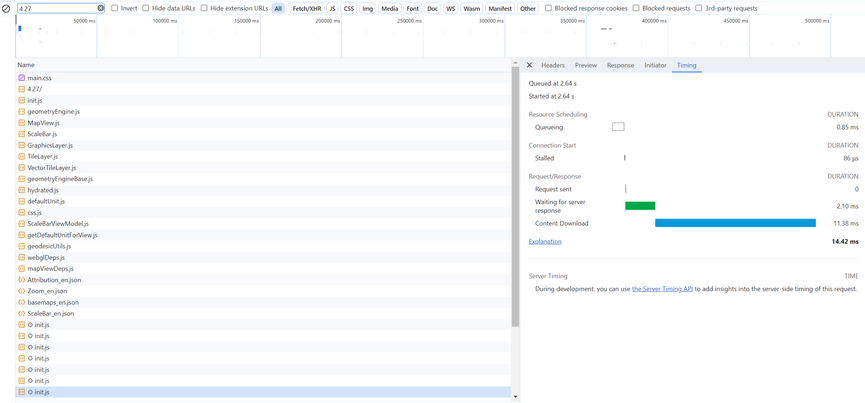

The reason i'm scrutinizing this so closely is because since we moved to 4.28, i've noticed we've gotten slower and i can see these 8 init.js requests get progressively slower. you can see they are stalled for long periods of time - over 100ms.  That's huge.
Whereas in 4.27,  we have the same 8 init.js requests but the longest any request has to wait is around 14ms. Absolute huge difference. I also notice the init.jst requests are launched earlier in 4.27. in 4.28 they seem to be launched later which further adds to the delay i'm seeing in our app

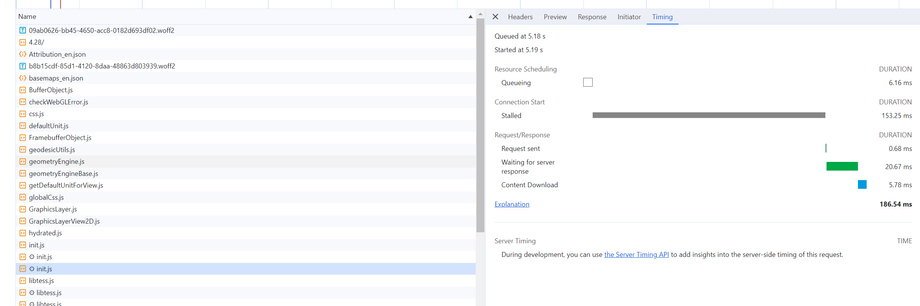

i just ran again this morning our app with 4.28.  i'm not seeing long stall times but i am seeing long server response times.  below is screenshot of the 8th request. each request to https://js.arcgis.com/4.27/esri/core/workers/init.js, the server response wait time gets longer until it reached the peak (of 211ms) in the 8th request.  Something bottlenecking?

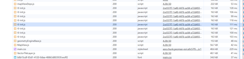

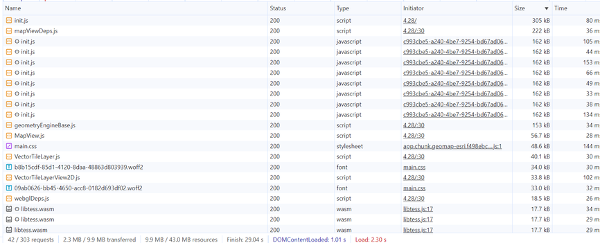

@JonathanTiuI I verified in Charles while using Chrome that the SDK's wasm requests are being correctly cached. Chrome 119 dev tools appear to be incorrectly reporting cached file requests as HTTP 200s. Here's a screenshot:
Also, the wasm scripts are being loaded correctly (synchronously). This is the pattern defined by the WorkerGlobalScope of the browser's Web Workers API,. More information is available on MDN here: https://developer.mozilla.org/en-US/docs/Web/API/WorkerGlobalScope/importScripts. As you may know, when stalls are reported in the network tab of the dev console, they can be the result of many different factors. Taking that into account, I didn't see anything unusual after multiple tests.
