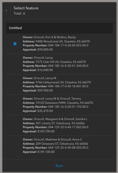

There seems to be a new item of heading in the search feature menu popup.   How do I change that from "Untitled" to something else or to get rid of it completely?

The value of that heading should be the same as the title property for the layer containing the graphics.  If your layer doesn't have a title, that could explain it.  Or, if you're not using a layer and adding your graphics directly to the MapView's graphics collection instead, that might explain it as well.

Both examples given use the exact same code.

The layer does have a title, see below.  I do add graphics directly, but the popup template is on the feature layer.  I will play around with it.   Is there a way to just not show the heading at all?

You were correct.  I used the graphics not the layer.
