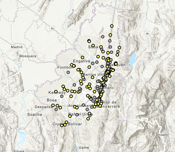

The points I want to change for the images are these:
EdissonGabrielLópezSalamanca_0-1615760085142.pngEdissonGabrielLópezSalamanca_0-1615760085142.png
link api (https://services2.arcgis.com/NEwhEo9GGSHXcRXV/arcgis/rest/services/Cicloparqueaderos_Certificados_Bo...?)
I hope you can help me, thank you.
