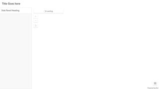

Hello,
I'm struggling to make a calcite-shell-panel "resizable". The docs suggest this should work, but I've been unable to implement it.  I'm assuming setting resizable = "true" will enable a grab handle on the element. Seems like I'm missing something.
Thanks in advance for any help on this!

Hi @dcarson1661 , I think all you need to add is a position property to your calcite-shell-panel. https://codepen.io/sagewall/pen/YzjVgEM
<calcite-shell-panel slot="panel-start" position="start" resizable ></calcite-shell-panel>
Sage_Wall
dcarson1661
That was it, Thank You!
