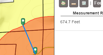

Hi all,
I am trying to buffer a road segment 200' on each side but it seems like the buffer is not returning me anything accurate. The buffer on each side is like 520' as it is now. Maybe wkid?
