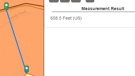

Hi all,
I am trying to buffer a road segment 200' on each side but it seems like the buffer is not returning me anything accurate. The buffer on each side is like 520' as it is now. Maybe wkid?
var extent2 = new Extent({
                    "xmin": -121.11087086999999, "ymin": 38.517479534000074, "xmax": -119.95226375799996, "ymax": 39.068026806000034,
                    "spatialReference": { "wkid": 4326 }
                //Map
                map = new Map("map", {
                    basemap: "topo",
                    extent: extent2
featureLayer.selectFeatures(selectQuery, FeatureLayer.SELECTION_NEW, function (targetGeometry) {
                            targetGeometry = graphicsUtils.getGeometries(featureLayer.getSelectedFeatures());
                            console.log(targetGeometry);
                            geometryService.union(targetGeometry, function (geometry) {
                                featureLayer.clearSelection();
                                //Buffer params
                                var params = new BufferParameters();
                                params.distances = [200];
                                params.unit = geometryService.UNIT_FOOT;
                                //Simplify features first
                                geometryService.simplify([geometry], function (simplifiedGeometries) {
                                    params.geometries = simplifiedGeometries;
                                    //do the buffer
                                    geometryService.buffer(params, showBuffer);
                            }, function (err) {
                                console.log(err);

RobertScheitlin__GISP
MVP Emeritus
Alex,
  Just add:
params.geodesic = true;
by Anonymous User
Not applicable
That works great with the ESRI sample ! Not too sure why it is not in my
app...
MVP Emeritus
Alex,
   Are you using an esri basemap?
by Anonymous User
Not applicable
Yes.
//Map
                    basemap: "topo"
And the layer I am buffering is wkid 102100  (3857) (WGS84)
MVP Emeritus
Alex,
   In your code you seem to be missing:
params.outSpatialReference = map.spatialReference;
by Anonymous User
Not applicable
Still not accurate. strange.
                                //Buffer params
                                    //do the buffer
                            }, function (err) {
                                console.log(err);
MVP Emeritus
Alex,
   The way I have found in my code to keep buffers accurate is to also use:
params.bufferSpatialReference = new SpatialReference({wkid:102003});
by Anonymous User
Not applicable
No luck. I am wondering if the union messes up the buffer
