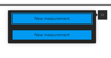

Building on this 'Solution'... Solved: Distance Measurement Component - change initial to... - Esri Community
Using the Expand widget replaces the button with an Icon but does not address the customization of the underlying 'New Measurement' button.  Why is this an issue?  Because the Area and Distance measurement component look exactly the same, and it's not a stretch to suggest users may need both tools in the same map...
How can we customize these two Components button-labels to distinguish them?  ... Bonus points if we can use the Expand  Component with the 'Measure' icon (referenced above) and also have both Measurement Components with meaningful text-labels (i.e., "Measure Area", or "New Area Measurement").
