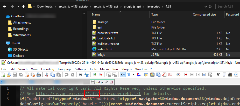

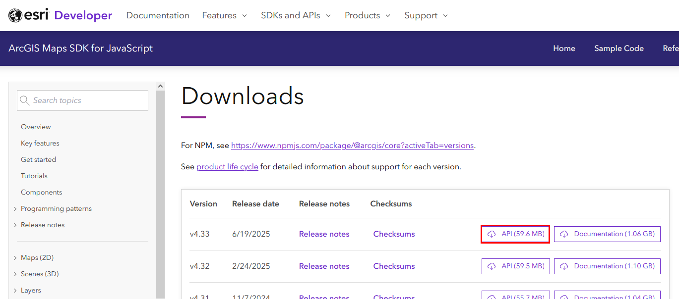

I just downloaded the 4.33 SDK from https://developers.arcgis.com/javascript/latest/downloads/:
It seems as if the old version 4.32 appears at several spots:
Furthermore, the build seems incorrect: JSAPI build date: Mon Mar 24 09:19:47 PDT 2025
I can't run this SDK with the 4.33 map components. My apps only work with 4.32 components.
Has the SDK been built correct?
