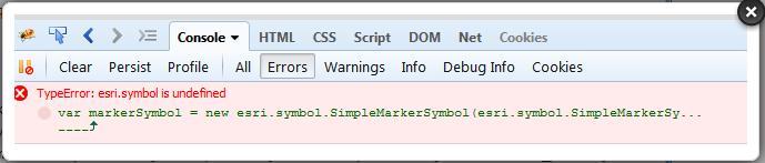

So after a little more digging I did find an error:

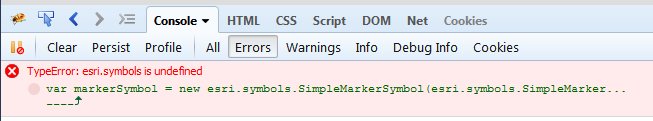

I tried adding the following require but got the same error:
dojo.require("esri/symbols/SimpleMarkerSymbol")
This is my markerSymbol var:
var markerSymbol = new esri.symbol.SimpleMarkerSymbol(esri.symbol.SimpleMarkerSymbol.STYLE_SQUARE, 28, new esri.symbol.SimpleLineSymbol(esri.symbol.SimpleLineSymbol.STYLE_SOLID, new dojo.Color([27, 236, 86]), 0.75), new dojo.Color([255, 0, 0, 0.30]));

NathanLindley
Deactivated User
Robert,
I tried to do a jsfiddle which is Edit fiddle - JSFiddle but I am not sure how to load a public map in.
Basically this code is what is causing an error in firefox/chrome but works perfect in IE:
Error:

  So you are using
and the correct object name is esri.symbols.SimpleMarkerSymbol
var markerSymbol = new esri.symbols.SimpleMarkerSymbol(esri.symbol.SimpleMarkerSymbol.STYLE_SQUARE, 28, new esri.symbol.SimpleLineSymbol(esri.symbol.SimpleLineSymbol.STYLE_SOLID, new dojo.Color([27, 236, 86]), 0.75), new dojo.Color([255, 0, 0, 0.30]));
NathanLindley
Deactivated User
I thought that might be an issue so I tried that before but didn't work.
When looking at the new way to do it, I noticed the format is a bit different with the require([]), etc.  But the scalebar works fine with the dojo.require("esri.dijit.Scalebar") so it doesn't really make sense for that to be the issue.
