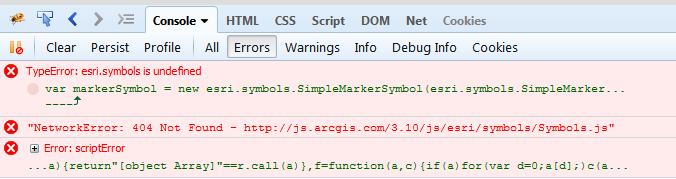

When I include: dojo.require("esri.symbol.Symbol); this error comes up:
I have tried pretty much every combination of dojo.require that I can and it still gets that javascript error on FF/chrome.

  Wouldn't that be
dojo.require("esri.symbols.Symbol");
ScottRutzmoser2
you are correct sir, esri.symbols.Symbol
NathanLindley
Deactivated User
Yep, tried that as well.  Same result.
RobertScheitlin__GISP
MVP Emeritus
Nathan,
  OK checking every spelling and use of symbols now (everywhere in your code that you have esri.symbol... it has to be esri.symbols intead:
var markerSymbol = new esri.symbols.SimpleMarkerSymbol(esri.symbols.SimpleMarkerSymbol.STYLE_SQUARE, 28, new esri.symbols.SimpleLineSymbol(esri.symbols.SimpleLineSymbol.STYLE_SOLID, new dojo.Color([27, 236, 86]), 0.75), new dojo.Color([255, 0, 0, 0.30]));

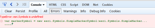

Edit fiddle - JSFiddle
Changed and same error:

Nathan,
   Try this fiddle. I think I have all the issues worked out
NathanLindley
Deactivated User
Thank you soooo much Robert, it works like a charm!
Very confusing that the require has a different path than the actual variable declarations.
Thanks again!
