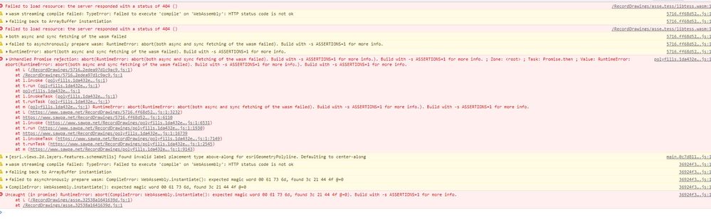

When started up a production build with optimization enabled, we get hundreds of these console logs:

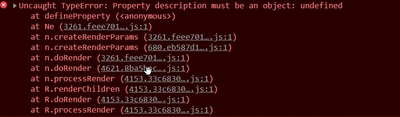

My map wasn't visible when I upgraded the cli to 12.2.9.  I downgraded the cli to 12.1 and used Tory's optimization configuration in the angular.json file and my basemap became visible, but a featurelayer wasn't. The errors thrown in the browser are attached.  Do all of the devkits need to be downgraded too?  I guess the best thing is to wait for 13 -- comes out Nov 3, 2021 supposedly

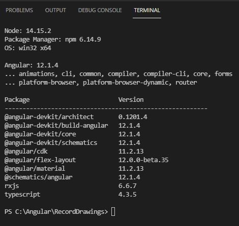

Yes, I had to roll back all the angular packages to 12.1 (12.1.4 is what we're currently running on for _all_ angular packages), once I did that, I did not have to use the optimization settings, things "just worked" as before.

PeteVitt
I rolled all packages back to 12.1.4, but still not seeing my feature layer -- a 404 error for assets/esri/core/libs/libtess/libtess.wasm.  I would think the error was related to something other than the upgrade, but the feature layer displays fine, and no console errors when debugging
AndyGup
@PeteVittthat sounds like a configuration issue. See this doc on Working with Assets: https://developers.arcgis.com/javascript/latest/es-modules/#working-with-assets. You can also compare your code against our Angular example: https://github.com/Esri/jsapi-resources/tree/master/esm-samples/jsapi-angular-cli
