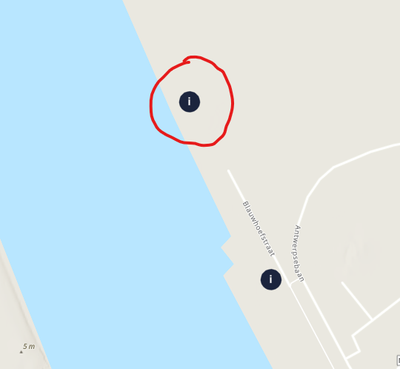

The CIM symbol's click area is too large when using CIMTextCymbols. When you click outside the icon's view area, the feature is still present in the hitTest results. So I assume it does not respect the frame with an icon font?
Reproduce:
Codepen: https://codepen.io/michaelk95/pen/poQReYy?editors=1000

Hi there,
So we just fixed this issue and you will be able to test it out on our next version. Here is your app pointing to next version: https://codepen.io/U_B_U/pen/ExOWVgr?editors=1000

UndralBatsukh
Hi there,
I am able to see the behavior you describe and we will be looking into improving hittest behavior to get the closest hit. I will update you once we update the hittest behavior.

I only see the issue with CIMTextSymbol related renderers.
For new releases it would be nice if you could change the tolerance for the hitTest?
