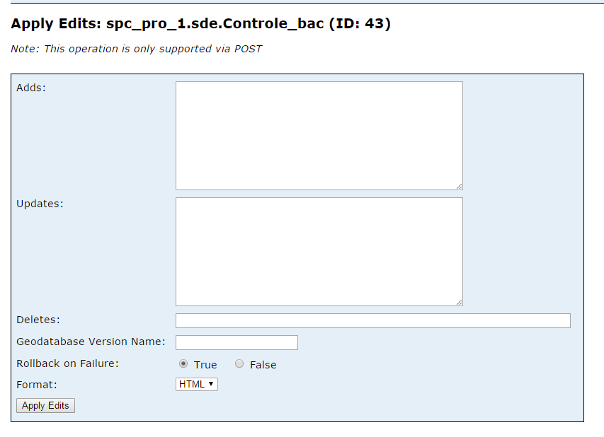

Hi guys,
I wanna display a table  (it's the result of a many to many relationship) then be able to updated it (editing the editable inputs),
My first question is will the function of "Attribute table" work for my table?
my second question what's the kind of query to send to the server in order to updated it ? (should be a graphic ) ?
( the image below)

Sara,
   You might have guessed from the lack of response to your two other previous posts on this, there are not many attempting this. What you send to the update method of the rest end point depends on the type of feature the relate points to. If the relate is just a table then the update would be a graphic without any geometry specified.
