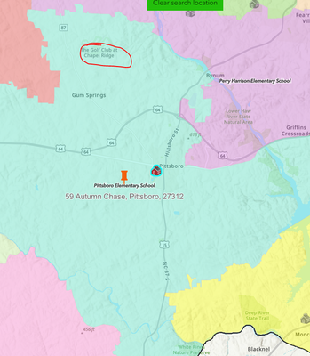

Is there a way for the map pin to go to the address that is entered rather than the middle of the zone it is within? Our workaround was to only have the address label appear because the pin is confusing.
It would be amazing to have the pin show up on the address entered so the end user could see where they are within the zone!
The image below shows the push pin going to the center of the zone rather than the address (circled in red).

Looks like this happens in cases where there is a search layer defined and an address is entered in the search box. We have a fix for this and it will get pushed to ArcGIS Online one night this week.

I removed the push pins and only have the address labeled to not confuse people but you can see the address goes to the middle of whatever zone it is in.
