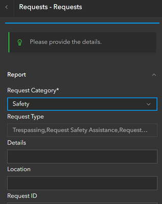

This is the closest that I got, but like this I am not able to select from the combo box dropdown as you can see on the picture. These values for category and type are domain values
var category = $feature.reqcategory;
var reqType = $feature.reqtype;
if (category == "Maintenance") {
  return ["Graffiti/Sticker Removal", "Sidewalk Cleaning", "Trash Removal", "Homeless Outreach", "Other (Please Describe)"];
} else if (category == "Safety") {
  return ["Trespassing", "Request Safety Assistance", "Request Safety Escort", "Other (Please Describe)"];
} else {
  // Return all options when no category is selected
  return ["Graffiti/Sticker Removal", "Sidewalk Cleaning", "Trash Removal", "Homeless Outreach", "Other (Please Describe)", "Trespassing", "Request Safety Assistance", "Request Safety Escort"];
