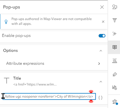

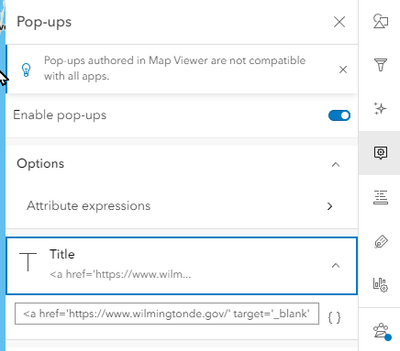

As for how the popup titles are set up in the underlying map, some are just regular hyperlinks, but some do use the field names to help format the html hyperlink.  The html is long, but here is how it looks for the Municipal Officials layer (2 pics to view the entire html):
Here's how the URLs are set for each layer:

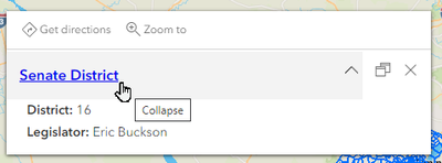

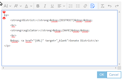

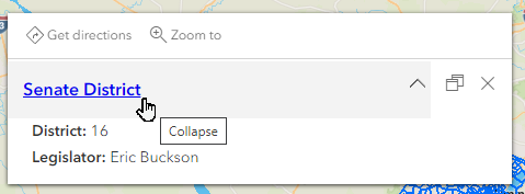

I do use custom Arcade Expressions to format the text of the popup, and they look perfect (but neither of them are a hyperlink).  For this TEST tool, I did add the exact same hyperlink htmlto the 2nd layer for Senate District, and that seems to work okay within the popup text.
