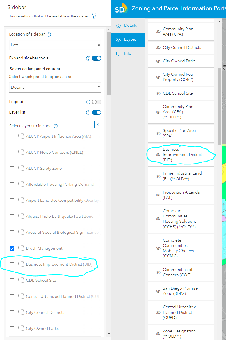

The Layer List for the Sidebar instant app is no longer working.  The app had been previously configured to only display 5 layers.  It is now displaying every layer in the webmap.
I need the layers for one of the pop-ups however I do not need them to be toggleable on and off.
Is there a work around for the issue?

I recalled previously any text in the Map accessibility section caused an issue after an Esri update.  I removed all text and cleared by browser cache. This has seemed to solve the issue.

Thanks for the update. We did have an update last night so that could've been what happened. Were you able to add the map description back in and see the layer list settings working as expected now?

That must have been what happened.  The instant app is in production and available to the public, so I'll leave the description off.

If it will be helpful, here is the links to both the webmap and sidemap app.  Since I have removed any text from the Map Descriptions – Map accessibility text field the Layer list is now displaying correctly.  The error was first reported this morning Feb 23rd, I am guessing it was related to last nights AGO update.
