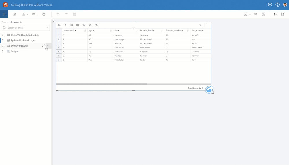

2) This sounds like something that was never brought to our attention before. There may be an AGOL architecture issue behind this too. I will ask around. However, I just created a video showing an easy way to count/sum <no data> values. I'm hoping this solves your problem, or at least helps you avoid doing everything manually. Please let me know if it helps. If not, I'll pursue the question further. 🙂
https://youtu.be/zGl493flmTc

This quick video shows you how to filter your dataset so that only 'no data' is shown. You can also quickly get a count of this data.

First things first: I hadn't noticed this before, and maybe you had, but I learned something new:
1. Strings are given the label <No Data> when they are left blank in an imported CSV.
2. Numbers are simply left blank when they are blank.
This doesn't help you per se, but it highlights why sometimes you can select <No Data> and other times you, when you have no values entered or zeros, you can't.
So yes, you can filter "no data" values from strings fairly easily. They show up as an option when creating predefined or other filters. But that's not your issue, I know... and...
It gets trickier with Numbers, because they don't show up. They are just blank. Or zero is not selectable. So you can't filter the <no data> values out.
Alas, ArcGIS Insights now allows us to write and/or import Python and R scripts! 🙂
In particular, using the Pandas library in Python, we can replace BLANK values in a dataset with a number that is easy to find and export it as a new dataset to our workbook, without impacting the original CSV data.
Plus, Python scripts can be included as part of any model you export to your different organizations/subunits to use. So theoretically, you can have someone run the same script in the same model every time with different datasets to get the same results. No coding required!
At least that's the plan...
The Python script I wrote (and will obviously share, so all someone has to do is drag'n'drop a file from the Table of Contents) works! I've got that down. The model part is next.

An even easier solution than using Python scripting?
Use ArcGIS Insights to get a Null Value count!
You can simply (compared to my last trick!) add a field to the reference table. Then type in "ISNULL" and then select the attribute you want to check.
Don't forget to rename the new field if you're doing this many times, obviously, or it could get confusing.
Sorry to take you on such a whirlwind tour. But we solved this! Next... to set up a model/template so everyone can do this automatically! 🙂
