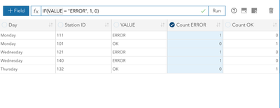

If I am understanding you correctly, you can solve this using table calculations in Insights.
On your original data, add a new field for the count of error and calculate the count
IF(VALUE = “ERROR”, 1, 0)
Repeat in a second field for “OK” using IF(VALUE = “OK”, 1, 0)
Now create a summary table using Day and Station ID.  The count will be created.  Now drag over your fields for Count Error and Count OK.
You can now calculate the percentage from that summary table, dividing e.g. Count error/count.  You can create another card, e.g. a bar chart from day and percentage.  Change the Statistic on ‘Percentage’ to AVG, to ensure that it is calculating the percentage correctly depending on the number of days rather than giving the sum.

VHolubec
Hello @LindaBeale
many thanks for this detailed workflow which has led to desired output! It works now like a charm.
At first I personally focused on working with status field filled with string values, which was the main mistake (so to split the one string filed to two string fields couldn´t help - anyway thank you also for tip @LauraBecht).
And at last, clarification from @LindaBeale (to use integers instead of strings in two fields) put me on the right way. So thank you very much, for help and great documented steps, it has helped me a lot!
