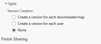

I didn't find any documentation stating these extra branch versioning settings for the reservation layer when sharing as referenced data to an enterprise portal.  The doc tells you to check sync and extract but nothing about the sync settings.  Or do i need branch versioning for the reservation layer? it's not quite clear.

Hello @Leo_GTRI .. database versioning (traditional or branched) is needed when there are multiple people working or collaborating on the same data and you need to maintain a 'default' state of your data. In Indoors, this is true for the kind of work that is done in Space Planner and only Occupants and Units require versioning as they are the only features that change. The Reservation layer does not need any versioning - it should always be only in one state so everyone using Indoors app to book workspaces can know the actual availability.
