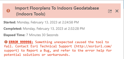

I'm having difficulty importing the CAD layers as well.  Mine gives me the following error.  I tried it twice.  One thing I'm thinking might be the problem is that the CAD has a single layer with all of the features - building polygon and unit polygons.  It's not clear to me if they have to be in separate layers.  Any help or suggestions appreciated.
GauravJobanputra
Hello @AmyNewsam may I know what version of ArcGIS Pro are you on (including any patches)?
AmyNewsam
Hi GauravJobanputra - I just updated to 3.0.4
