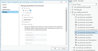

I'm working whit ArcGIS Indoors set up the Indoor viewer using data referenced and branch versioning.

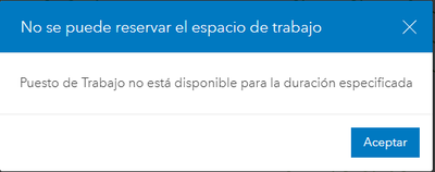

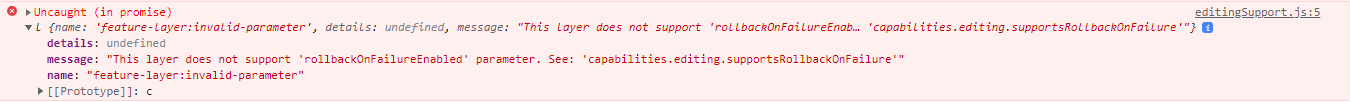

at this moment the web app shows me the units that I can reserve, but when I click to make the reserve, I get back an error.

Hello @SimonMarin only Occupants and Units are supposed to be branched versioned. There is no versioning needed for Reservations. Can you please check your feature service and confirm?

The reservation's layer has the branch versioning activated, but I can't disable it, because it is in the indoors dataset where are the units and occupants layers.
So please tell me if I could delete the layer reservation and create it again outside the indoor dataset.

Hi @SimonMarin, were you able to get the Reservation layer shared separately and get this to work? Even if the dataset is registered as versioned you can select not to enable version management when sharing as a web layer.

@Leo_GTRI version management can be enabled selectively when sharing as a web layer even if the dataset is registered as branch versioned. Space Planner requires only Occupants and Units to have version management. Reservation layer is only used in Indoor Viewer and should not be shared with version management enabled.
