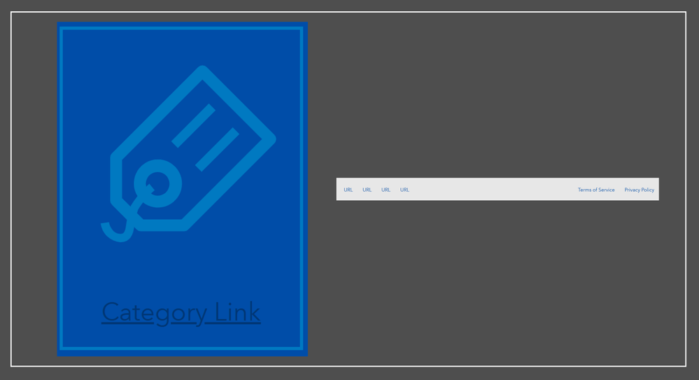

Your site theme uses blue link text, which looks great across most of your site, including the footer. But you have placed a Category card on a blue background, causing the blue links to disappear.
Changing the body link color to white reverses things such that your Category card link is now visible, but your site footer links are invisible.

Currently, the Category card inherits link colors from the site’s theme settings. This ensures consistency across all cards and sections, including the footer and navigation elements. While this works for most cases, it can lead to contrast issues, especially if your card background and theme link color are too similar (Example; a blue link on a blue row illustrated above).

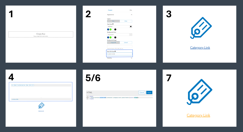

If you are working with the current Category card, here’s a temporary method to override the default link color by adding embedded CSS to a Text card and applying it to the Row that contains your Category card for example.
1. Add a Row card to your site layout.
2. In the Row’s settings, give it a CSS Class name (e.g., “custom-name”).
3. Place your Category card inside that Row.
4. Add a Text card anywhere on the page.
5. Select the “Edit in HTML” link at the bottom of the Text card.
6. Paste the following CSS snippet into the HTML editor. Be sure to:
> Update the class name to match your Row’s.
> Set your desired link color (e.g., white, orange, #123456, etc.).
<style>
   .layout-section.custom-name .container .category-card .panel-footer {color: orange;}
</style>
7. Save, publish your site, and view published site.
