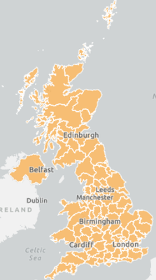

Hello,
I am want to use the ArcGIS Maps for Power BI visual to display our orders based on Local Authority Districts / Unitary Authorities in United Kingdom.
What I have noticed though is that some Districts do not display properly.
The ones that do not display although we have sales from those areas (e.g. using postcodes you can see points in those areas) are the following:
Wyre Forest, North Northamptonshire, West Northamptonshire and Buckinghamshire
You can see what is missing in the following picture although we do have sales from those areas.
Is there any way to fix this in Power BI or does the fix have to be applied from esri?

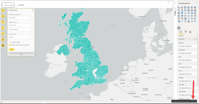

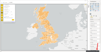

Hello.
I am not sure what you mean by feature service. I just use the ArcGIS Maps for Power BI visual. I use the free version, so I do not have any subscription with esri. I guess that would be ArcGIS Online?
These are the settings I am using:
Counties also do not work 100% correctly but those are kind of weird in UK so it is hard to get them right and I do not intend to use them. However, Postcode Area works correctly.
For example, here is a picture when using Postcode Area. As you can see there are no uncoloured areas.

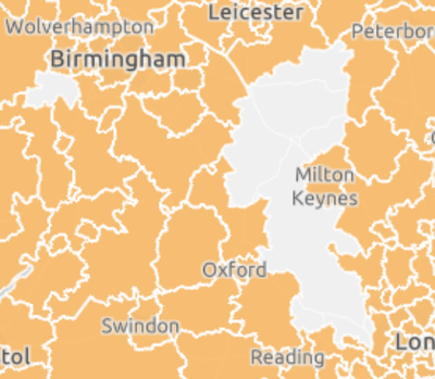

I have only recently started using this visual so I do not know how it looked in the past.
The issue is definitely with the source data which based on what you said comes from geoenrichment services.
As I said before, the missing spots on the map come from Wyre Forest, North Northamptonshire, West Northamptonshire and Buckinghamshire.
I am not sure about Wyre Forest, but the other ones were only recently created, in the last 6 to 18 months.
North Northamptonshire and West Northamptonshire  are new unitary authorities created and Northamptonshire was abolished.
Same for Buckinghamshire which I think includes Aylesbury Vale, Chiltern, South Bucks and  Wycombe districts which were abolished.

Hello,
If it helps, it looks like the Wyre Forest district is being mapped on top of the Wyre district (similar names but different parts of England).
West Northamptonshire and North Northamptonshire appear to be plotted on top of one another.
Still don’t know where Buckinghamshire is hiding though.

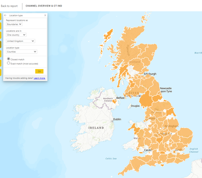

I know that this topic is a bit old. Is there any update on the UK counties topics?
I have the same issue, some of the counties are not properly visible on the map. Do you have any advice for me how to solve it? I have attached picture, where you can see that some of the areas are not visible. Is there any list of the counties name that I could use? Maybe it is just a difference in the naming..
