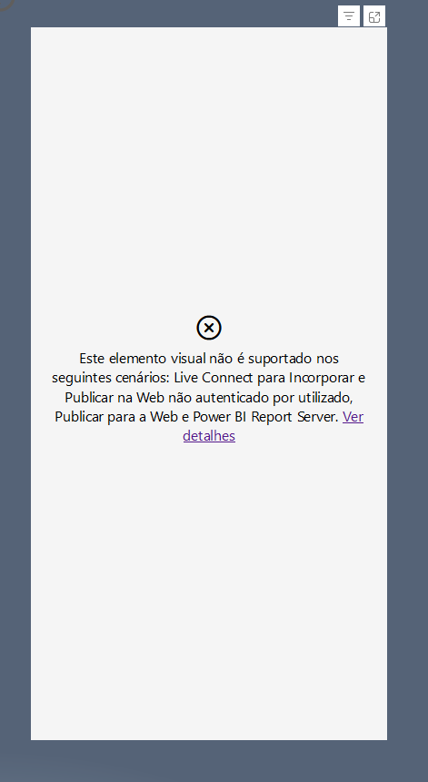

I Publish my BI report to the web however the map visuals are not displaying in the published dashboard, they work just fine in power bi desktop and online. It appears a message saying "este elemento visual não é suportado nos seguintes cenários: Live Connect para incorporar e publicar na web não autenticado por utilizado, publicar para a web e power bi server" google translated to "This visual element is not supported in the following scenarios: Live Connect for embedding and publishing on the web not authenticated by the user, publishing to the web, and Power BI server"

For embedding can you confirm that you validate in the Settings pane, in the Embed and publish check category?
Can you also check that your report meets these requirements: Embed a map-enabled report—ArcGIS for Microsoft 365 | Documentation

Yep, that’s a self-imposed limitation of the visual. My understanding is that you must share the report with people who are licensed and have permissions in PowerBI for the visual to work.
