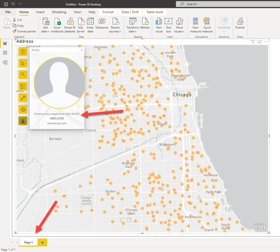

When returning to a Power BI report with an ArcGIS for Power BI visual, I am often logged out from the ArcGIS account I used to build the visual. I cannot find a way to log back in to the visual. I have to delete the visual, add a new one, log in and rebuild te visual.
Why can't I log back in from within the existing visual once it has been build? Or am I missing something here?

1. Open your Power BI Report. Double-check to make sure you aren't logged in.

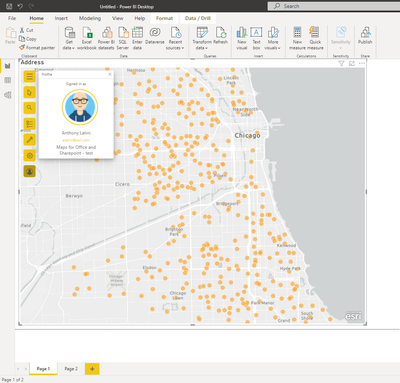

2. At the bottom of the report page, click on the + icon to add a new page.
3. On the new, blank page, add our visual.
4. Click on the appropriate sign-in you'd like to use (ArcGIS Online or ArcGIS Enterprise) and sign in with your credentials
5. Tab back to the original page where you checked to see if you were logged in. The map should now pick up the credentials from the blank page and sign you in.
6. You can delete or remove the new page you created.
