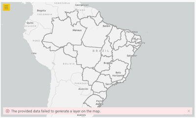

I have the same problem, but it doesn't use any data field. Some days it works, but other days it returns the same message

I am getting the same error, but I hadn't changed anything or involved a date field. The same map in Power BI that could display a layer last week, now generates "provided data failed to generate a layer on the map" error every time I try to change a layer on an existing map, or create a new map.
