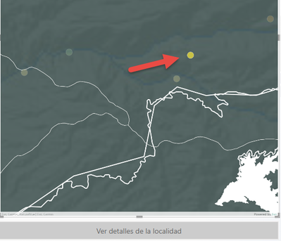

Hi Guys,
I'm struggling a bit right now while trying to use a drill button that I have in one of my reports. This button acts like Drill through and whenever you select a point from the map, you could go and check relevant information from that location.
With the last update from June, whenever I click in one of the spots from the map, it doesn't allows me to use the button.
To discard if it was something that i was missing in the configurations, I use the same button but with another map and is working properly.
Could you guys please fix this or let me know if I'm doing something wrong.
Best regards,

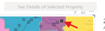

I'm having the same issue.   I have a map that shows locations and when I select a location the tool-tip says "Right-click to drill through", but this is for a public report and most users won't know what "drill through" means.
I need the button I set up for drill-through to work.

Roland_at_Planet
 @AnthonyLatini - Thank you for the response, and I'm sorry if I wasn't clear. I'm not using modern tooltips.  What I'm trying to do is use a button to drill-through when a location is selected.  This was functional prior to the recent update.
The button would be disabled until a location was selected. Once selected (as displayed in the screenshot), the button would be active and drill-through to another page in the report.
nglchased
Complementing what Roland said, I have the same case, whenever I select a point on the map as you can see in the image below, the button does not work as it should, before the update when you selected a point, the button was active and drill-through you to another page of the report.
