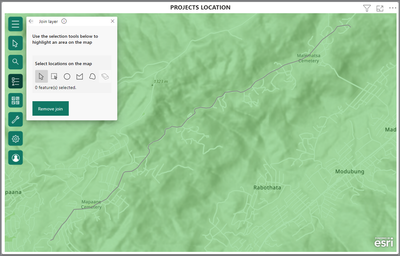

EvansLion
Hi
The interaction between ArcGIS and Power BI visual only seems to work when the "join layer" widget is open for a specific layer as shown in the screenshot, otherwise it just doesn't work. Is this a known bug to the developers? Are there plan to fix it? It would change a lot if it were working correctly.
