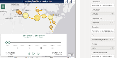

these vehicles must be counted separately, and each vehicle has a "time of arrival" column.
i need to aggregate the number of occurrences by vehicle and want to use the color to show the time of arrival.
if i put the "id_oc" field in the size field, when aggregating it results in a wrong total number.

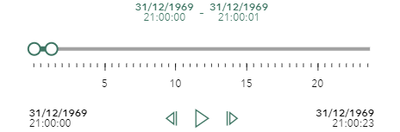

oddly(?), the only way i achieved to get the correct total number was by putting the "time of arrival" column in the color field and an index column in the time field. but it does result in a completely wrong date in the time slicer, as shown in this bottom print.

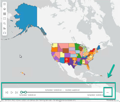

The new version has been released on June 26th. If you still want to use the Time field, you will see the new time slider like this. If you click on the minimize button, it will be minimized to an icon at the bottom.
Please let me know if you have more questions! Thanks!
